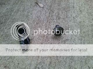

ok, looking inside, this bolt and piece of plastic were laying next to the link that goes down into the lower unit from the top.
It's a hex style bolt, but do not see where it came from, but needless to say that did not resolve it.

carefrully inspect the shift and throttle cable holder.
that plastic piece almost looks like the clip that locks them in place.
it could also be a clip that holds down the trim leads or the fuel and oil lines.
