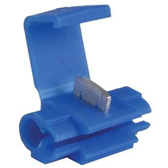

I did not see point on keeping the distributor when the motor I purchased came with everything included. However the motor was not set up with the serpentine belt system it was the older V-belts. I transferred over all of the pulleys and the needed systems to have the motor running. I do not see how I did any sort of disservice to myself considering it was the same motor, same size, same brand etc. I have included the picture of the distributor cap and the coiler.

I see what appears to be some scotchlok connectors in your wiring. You need to get rid of those.

The core of your problem is that it looks like someone hacked into the original wiring harness, based on what I see with original connectors with blue scotchloks.
There is now a combo of connectors that connected to the original distributor with scotchloks added to them to connect to this points distributor. Unless you have a ballast resistor in there connected to this points distributor, you will overheat your coil.
In addition, using scotchloks to connect to the original wire harness is a recipe for disaster down the road or may even be your problem now since they can vibrate loose and corrode.
