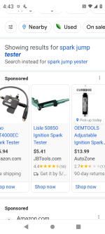

Spark jump testers....here's a low cost one.
