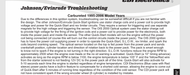

My motor has always seemed to starve at the top end but the last 3 outings, I get on a plane and am cruising along for about 5 minutes and I feel a bump or two and then it just shuts off. The first two times, it took over 30 minutes before it would start again and then it seemed to run okay (not great but okay) for the rest of the day. Last outing, it started up after 10 minutes.
I do have spark on all cylinders and compression. I am suspecting the power pack may be intermittent. I have checked all of the wiring for chafing and connections are good.
Can any of you help a brother? How can I check this power pack?

Thanks for chiming in racerone. I don't think it is overheating because it will run the rest of the day after that initial period of shutdown but I can definitely look into that. I haven't installed a new impeller but the stream is strong out of the back port. Carbs are all straight and were recently cleaned up 2 years ago. Thanks for the guidance and tips for sure. I am sure it will take a bit of troubleshooting on this one, especially since it is intermittent.

Run with a timing light , one cylinder at a time.----Observe the flashing light when motor acts up.

Could be possible optical eye failing
I was wondering about the optical sensor. I did a bunch of troubleshooting today and pretty much boiled it down to two things, the optical sensor or the power pack. That is, if the spark plug change doesn't make a difference. I can't really see the optical sensor though cuz I can't get the cover to come off (one that has the data on it) because it is pretty stuck and I don't wanna break it.
I am not new to boats but am semi-new to this one since I inherited it from my dad when he passed in 2020. He did swap the spark plugs for NGKs and they are a direct replacement according to cross reference data but they do not appear to be exactly like the actual Champion plugs which I just bought and installed. I am gonna take it out Tuesday and see how it does. It runs really well with the hose but that doesn't mean much since it seemed to do the same before. Worst thing is, I can't replicate this failure with a hose cuz it seems to happen when the motor has run about 5 minutes at full throttle.

something here may help
see page 69
if you suspect heat related issues you could always quickly cool down a suspect compoment with a simple keyboard spray can from the dollarstore... inverted they will cool things quickly to clear up a heat problem an confirm the problem area .. work outside and take care in case of igniting fumes
up to you...suggestion only
