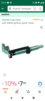

Well your in it now. Go online and seek out testing all those components and then you should have this tool to put everything back on so they are set right in relation to the flywheel.
Look and see if any of those components have wear marks where they might have rubbed on the flywheel.
