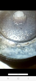

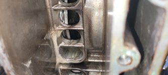

Since you said that water was definitely getting into the exhaust chamber then I would think as each piston went up and down it could introduce water into that cylinder. The water comes in under force from the water pump so I can rationalize this. On the one piston being wet and the others dry, possibly that one was ready to fire (wet) but didn't due to engine timing not ready for that cylinder to fire when you stopped it.
Compression is fine with me. On the water getting into the bearings, that surely would be something that needed to be addressed immediately. I don't know how to address the how to on that problem, never had it. Maybe one of the guys that answered and know how to fix that problem can direct you.

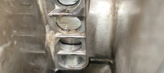

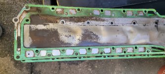

Yeah I opened it up it and it was definitely water, all the pistons are pretty clean ans shiny. The bolts for tye cover were tightened twice and some were still loose when I opened it.

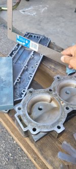

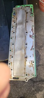

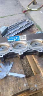

I took off the exhaust cover and had to re-surface it to make it true, it was off at 0.20in warp which is a lot, I made it to 0.002, it will be perfect now. I got a new separation plate and gaskets, will use some kind of gasket maker for high temp, recommende blue 750 sealant for the bolts and cross my fingers that it solves the water problem.
With the water gone I hope the dying in gear at idle will be gone. It should be.
I took off the power head also. It was holding conpression pretty good but wanted to see inside. This motor is almost all brand new now including the lower drive. Better run like it too.

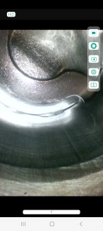

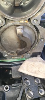

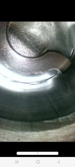

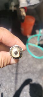

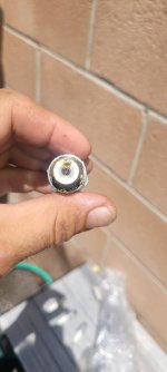

Do not change prop pitch to get the RPM you want.----Repair the motor to get rated power !----Piston is scored !

The picture you're reffering to is the piston with some drops on it. Here is the picture after I wiped it.

I don't see it, but the way this motor was running and the adjustments it took to keep it running in gear at idle, I would not be surprised. One thing is for sure it was not running lean but it did have some alarm buzzing from briefly overheating issues in the parking lot on a hose tests early on. Now I run it in a tank and it seems to like it better. But it did manage to have 140 and 135 compression. That is not too bad. So the goal now is to put it back together and resolve the exhaust water leak issue.
Hopefully that will get the idle issue in gear to be normalised. I mean if there is no water entering the cylinder the fuel burning should prove to be better right?
I should have checked the exhaust cover
with a straight edge when I first rebuilt it.

So one would ask why did the plate separating the cylinder's exhaust gasses from the cooling water warp in the first place? My answer would be that it didn't receive the cooling water of the engines original design. My understanding of cooling loops is that they are 2 separate circuits whereby the exhaust gets uncontrolled water and the combustion part of the block gets thermostatically controlled water.
You might check your exhaust cooling water passage and ensure that its not clogged by sand or weeds.....how would you do that? Water hose in the outlet of the cooling chamber, looking for water where the exhaust exits the lower unit, while you have the cover off and then put the LU on muffs with a goodly amount of water pressure, take the plugs out and spin the engine with a good stout battery to see if you are getting water to the chamber......is the way I'd do it, not having done it before but seems a reasonable way to make the determination.

This engine was rebuilt after cylinder number 2 had zero compression, cyilinder was pretty marked up, and rings were cracked. After 34 years I think it was time.
So it went through some rigorous cleaning. Was completely dismantled.
The warped cover was pretty much overlooked that's all. I checked the engine surfaces but not the cover.

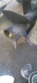

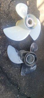

Anybody have any idea where to find props that fit the 4in gear box? Everything out thwre is for 4.25 drives. I have 13x19 turning point and want to go lower to a 17 or 15. I bought 2,13.5 x15 and they are too large for the inside of the drive by .20 or so. Can they be grinded to fit? That's the only difference.

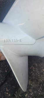

I have a white 13.5x15-k prop but the end is very thin so I think it was grinded could not find anything similar. It's probably for a yamaha but it fits my 1990 120hp fine.
I have numerous Turning Point Hustler, 13+ diameter, 4" hubs, purchased here, that were 3 and 4 blade aluminum props. Never had a problem. Engines were 90 and 115 Mercs. I didn't specify nor pay any attention to any remarks about the hub diameter. I just relied on the fact that the 13" dia. props ran on the 4 and 14" ran on the larger diameter, higher HP engines......was not disappointed on any of those half a dozen props.
I do recall while playing with different props on a couple of boats with these engines that I somehow acquired a prop that didn't have the notched front end of the barrel that fit up inside the LU casting. I guess it was made for the 4.25" gearboxes. With the OEM thrust washer, the prop would strike the LU casting.
I went to a marine dealer that had been in business for decades and he had a wall full of used props and a box full of thrust washers. I took the box out to my boat and played with the washers till I found one that caused the front of the barrel of the prop to fall about 3/8" behind the LU casting outlet.
It was far enough back so that I could push on the prop in F gear on the low part of the "over run clutch sawtooth" and it didn't contact the LU casting. I ran the prop and even though there was a gap I couldn't tell that it was any detriment to performance. I just figured that any problem would be during high performance operation and the slipstream would go right past it and wouldn't even know that it was there.

I got 2 props 4 blades 13 3/8x15.
The props I got are Michigan wheel Vortex 941415.
The only ones that have a 13.75 lip that fits in my 4 in drive. I think they are good props and brand new at 70 bucks a pop shipped. They run 130 each originally. It won't break the bank.

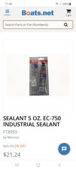

So once I get the parts to put back the exhaust cover with separation plate, gaskets plus the head and gasket I will test it again. I got all the parts except the new separation plate. I found it new so I said screw it I am buying it. I don't want any more surprises. I will use some permatex aviation liquid sealer on the gaskets and the RTV blue silicone gasket maker 587 also known as 750 or FT8955 suggested by Crowley and the factory manual for Force bolts.
I could use Loctite also but am not sure which one.
My friend has the Loctite 542 medium sealant that he uses on his motor bykes. I used that on the intake bolts.

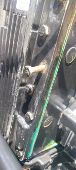

The exhaust bolts were pretty loose before. I could not get them to stay.
So when I check the exhaust cover with a straight edge is was off on the sides by 0.020. I used a special stone and repaired the surface now it's at .002 or less. That should fix the issues with the water leak in cylinder 4 and some in 3. But mainly 4. And it should fix the issue with dying in gear at idle if the RPM is set by the book at 750 in gear, which was impossible. I had to set it at 1100 in the water and 850-900in gear and even then it would die. Eorked great in the parking lot on a hose. At 3k RPM it was smooth along with the other engine. By itself it would cough and bog down at first and then work somewhat. So this is where I am at.

I use that Aviation sealer also on occasion where I feel it is needed. Locktite blue is for fasteners that one expects to remove from time to time. Red is for permanent applications and if removal is required, it is said that heat is a necessary aid. Locktite seals on compression so you have to have 2 surfaces in compression for it to cure.
I find your comment about the screws, not getting them to stay, is a worrysome comment. I never used silicone as a thread sealant.

yeah those bolts were from the exhaust cover. It was warped ajd I assume that caused the bolts to not completely torque it. That's why it probably leaked in the cylinders and also the right side bolts showed rust. I will probably be using the blue loctite to make sure they stay put. The cover is now straight and true.
