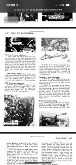

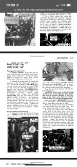

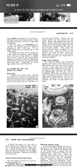

Mattwill00
May 17, 2022
7
This is what I’m working with this far. I did find the specs for primary and WOT (7-9 deg, 32 deg BTDC) at the back of the manual, I guess I’m just confused on the wording of the manual. Thanks for
being so helpful too, I know this stuff might seem pretty elementary to some folks here. Im really just hung up on what screws to adjust when.
Mattwill00
May 17, 2022
7
So for the primary pickup timing, set it at the correct timing spec when the carb is just barely opening? And use the full throttle stop screw? Then use the WOT Screw and set to 32 degrees? I think I’ve got it… some confirmation would be awesome though! Thanks for the help
