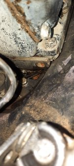

water is pouring through this hole in the rear bottom , what is going on?
T TnRandy66 Recruit Thread starter Joined Jul 13, 2021 Messages 2 Jul 20, 2021 #1 water is pouring through this hole in the rear bottom , what is going on?
Faztbullet Supreme Mariner Joined Mar 2, 2008 Messages 15,938 Jul 21, 2021 #2 The aluminum plug is corroded or frozen and pushed out....looks like it pushed out. Looks like it in bottom cowl
