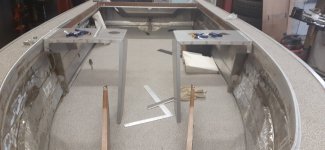

As it sits now flooring is 90% secured down will pick up more fasteners tomorrow.
Top of gunwales has new vinyl layed...then I decided to pull the motor to paint the splash well....then I decided to pull the transom and replace the wood. (Backwards I know)

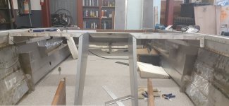

Since I still have motivation before I can get more hardware and marine ply to build a new transom.
I am taking on another side project not intended.
The consoles being angled to the sea side drove me nuts as everything wanted to make it's way overboard so I am reworking the consoles to make them sit level. Quick easy project.
Already plan to replace the dash wood as well as the wood in front of the console so I might as well.
Now when the boat is done and back in the water all of the wood will be new. Good for another 30+ years.20201108_203244.jpg

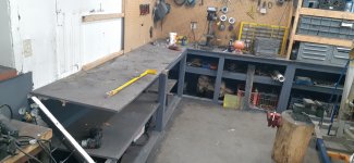

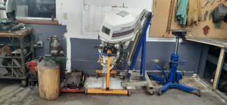

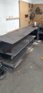

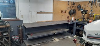

Well I've been busy working away in the garage, unfortunately I got sidetracked and revamped things a bit. Rem ou ving 9' of workbenche. Garage had 36' total
I did purchase the needed 3/4 marine ply for the transom and got it cut to rough size. Also picked up more epoxy and 1/2 marine ply for the gunwale storage area.
Slowly but surely.
Tonight i moved the stereo system in the garage to round out the revamp. Just some final cleanup

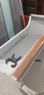

Added another coat of epoxy to the bow pieces today. Tomorrow morning I will add the last coat before wrapping them in vinyl. Will also paint to bow aluminum tomorrow to cover the wood grain.
Picked up another epoxy kit as I still need to cut and coat the gunwale wood pieces as well.
