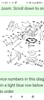

I think I found it in the parts diagram. Listed in the intake manifold section.
Do we happen to know if it is part number 0314807?
Looking at the contour of the part in the diagram, I can tell the one I have has been modified for expressly improved performance.
Thanks again,
J
p.s., if anyone has a picture of the spring installed, I would appreciate a peek
Thanks again,
J
Not sure what your looking at but I found it in the carburetor section. It goes on the middle carb. I'm sure if you look close enough to the middle carb you will be able to deduce how it goes on. Spring ends will rest on the carb body and shaft area.

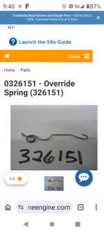

The spring I have is definitely the 314807. Used between 1974 and 1982.
I did find a picture of a "good" spring so I can reform what I have to factory spec.
I just have to find a home for it.

I looked at the model number you gave plus a 1977. I find the same one that I found before. Also, I don't see it in the intake section...I see it in the carb section. Maybe yours is deformed or just not seeing what your seeing.
