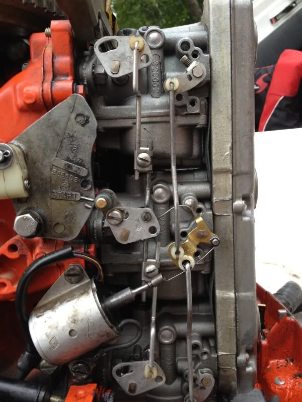

I have a 1975 Johnson Stinger 75 hp. Yesterday I took it out fishing. Everything worked well as always after the last tune up. But when I try to restart it to change spot I couldn't get in to start. I had to paddle back to the launch. Fun times. Anyway, I have been looking at it. I'm no mechanic but I think I found the problem. It seems there is a spring connecting the gas link and choke link on the carbs either broken or disconnected. I just.cant figure out where it hooks up. If somebody with same engine could post a picture it would be great. I tried to manually open the choke and the engine started right away. I have picture. It can't post as I'm camping and only have my iPhone.
Any help would be greatly appreciated!
Cheers
Fred!

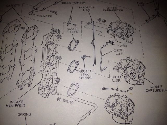

I have the service manual....do you want me to post a pic for you from the manual? Or I can take a pic of my '77 75 Evinrude? Let me know.
ptemomo
Jun 20, 2011
13
Re: 1975 Johnson 75 help
Either would be great. The one that easier to see I guess. I'd love to be able to get it running before the end of vacation.

The video is great. Thanks. The spring I am looking is the one just on top of the choke solenoid. It's hard to tell on the video but is it welded on the link or it's resting on something? I'll have to check mine in the am. Thanks again!

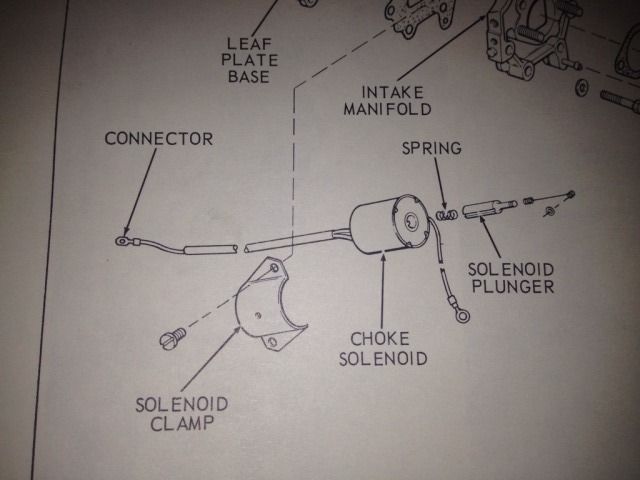

BonairII
Jun 7, 2011
2,727
http://www.youtube.com/watch?v=fSJ0hnHvxpA
A few pics from my service manual

Looked at it again this morning. You're videos helped greatly! I figured out my problem is with the choke solenoid. The plunger is loose in it. So I guess I need a new one. But looking in the part catalogue it shows as obsolete. Does it mean I'm out of luck or it was replaced by another part?

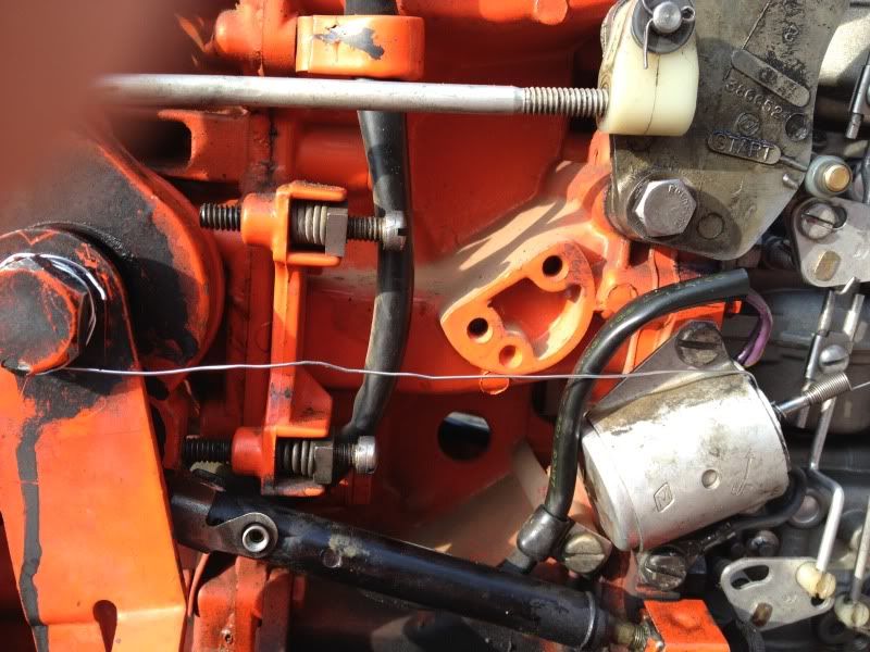

The plunger won't stay in. Looks like a retaining ring went missing or something. I tied it with some wire for the time being. I'll look for the manual choke. Never did notice one before.

That was the problem and how i fixed it for now. Thanks everyone for the help!! Good thing is it finally convinced my wife to let me buy a new boat :)
