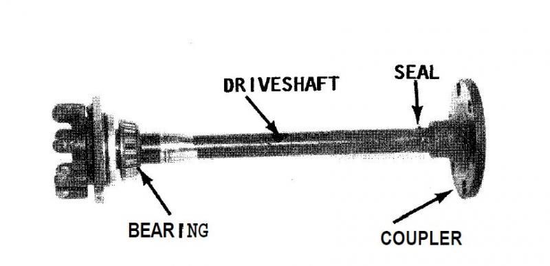

I removed the bolts that hold the engine to the intermediate. But the flywheel will not break free from the drive-shaft spline I believe due to heavy rust. I know this should typically slide in and out but for the life of me and a 6 foot pry bar I didn't want to force the bell housing of the intermediate and engine block apart and potentially cracking the housing/tabs of the intermediate.
How should I go about removing the shaft from the flywheel? After downloading the aftermarket Manual for the OMC sterndrive, it seems if I remove the out-drive I could perhaps use a puller to possibly force the drive-shaft off of the flywheel section. Any input would help. Any suggestions about how to remove the splined section of the drive-shaft off would help a ton.

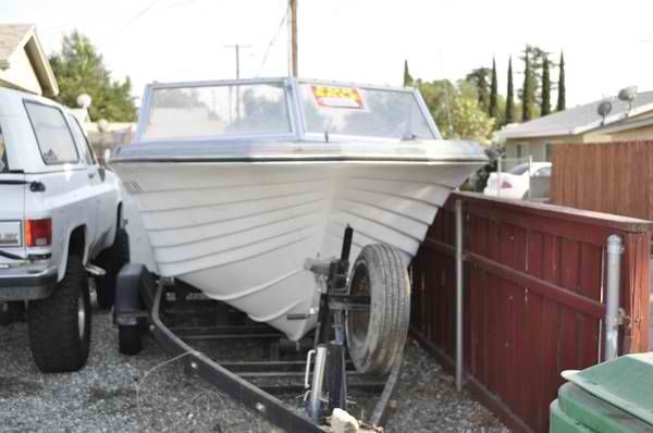

Here's pictures of it in all its glory. The neighbor supposedly was trying to repaint the boat and rebuild it but failed miserably due to medical issues. At least all the rails and horn are in the boat still.

Before I could get all the "bad" stuff out I gotta get the drive shaft off the coupler attached to the flywheel. Here's a picture to show what I'm having trouble with.
Since the splined portion of the shaft is stuck to the coupler there is not enough room to cut between the bellhousing of the intermediate shaft and engine block. Wish it were easy to cut it out! But I have about 1/4" clearance max between the two with no visibility.

Yeah. Maybe a thin long hacksaw blade?

take the drive off, take the boot off and maybe the intermediate will just come forward through the transom hole? It fits through the transom on the later rectangular hole stringer drives, but not sure about that round hole. I'm pretty sure boat builders received the engine with the intermediate attached and dropped it in that way, so it should come out that way.

I do have a 18v dewalt sawzall that shreds the frame rails on cars right up. I'm pretty sure a hardened shaft will be a lot more difficult to cut through with that. I'll have to see. I'm thinking of making a puller that will pull the shaft from the intermediate with substantial force (excess of 8-10,000 lbs) should break it free from the coupler. Hopefully nothing goes wrong. :faint2:

I could pull the motor and intermediate as pictured above. But I'll still be stuck with the intermediate attached to the block by the driveshaft not wanting to come loose from the coupler on the flywheel. But at least its out? Which is more progress that whats its currently at. Thanks for the picture. If he did it and the manufactures did it as such, I'm pretty sure I can as well. :)
