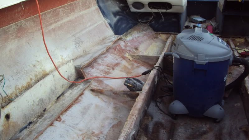

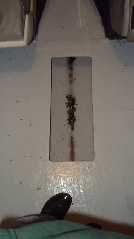

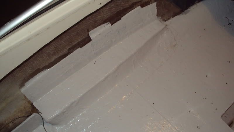

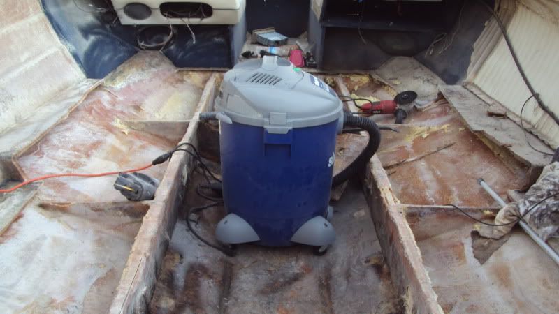

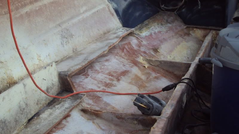

After sanding the whole floor down, I used 1708 to glass in the sides and seams and went over it with a layer of 1/4 oz CSM. I would have done another layer of CSM but I would have had to buy another 5gallons of resin and after going through the pros and cons of adding another layer of CSM, it seemed almost overkill and that would mean ordering another $300 bucket of resin and waiting on it to come in. I however opted to purchase 2 gallons of resin locally and continue the rest of the glassing, doing that saved me $240. You will see my take on deleting the old back to back seat boxes. I was going to try to use 1/4" plywood and fill it in that way but this was much easier. I bought some fleece from Wal-Mart and using 3M spray adhesive made my mold over the cut out. You must spray both the back side of the fleece and where you will attach the fleece to as well and wait for it to tack up. Once its ready start at the top and stretch the fleece down tight but do not pull the material apart. At that point you can "form" it to what you want it to look like and press out the wrinkles. Cut off the excess fleece and allow it to dry a little more. Once dry you can start spreading your resin on it and allow it to soak into the fleece. I would advise to let the resin dry before adding your glass as it is a sort of pain to getting air pockets out of the glass on the "voided" area. However you will use less resin in the end if you go ahead and glass it while wet. The fleece will be so saturated with resin you will almost not need any additional resin on it.
I put a layer of 1708 and 2 layers of 1/4oz CSM. Another piece of advise, try not to go out as far onto the floor as I did with the fleece. Try to stay close to the edge of the wood as it will be easier to sand and hide the seam.

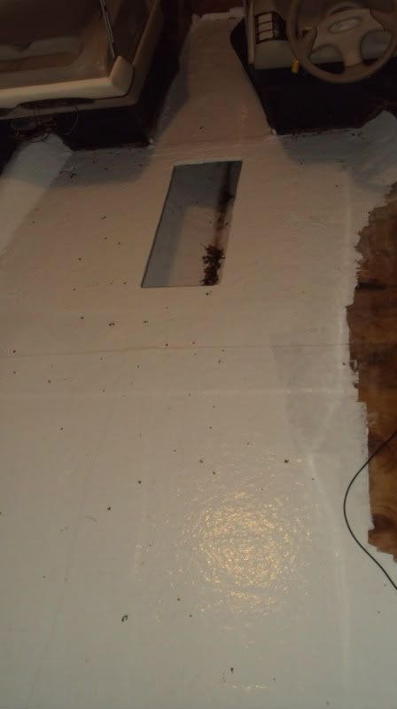

After everything was dry I went ahead and painted the floor with Rustoleum White Enamel. You will also see how the deleted seat boxes came out. I wish it had came out better but it will be covered with carpet and wont be noticed. That is why I suggest trimming fleece down to a minimum. I kind of thought about installing some led lighting in where I glassed over the old boxes for lighting at night. Not sure yet.

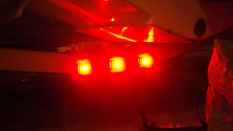

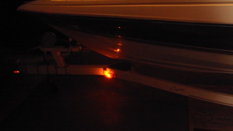

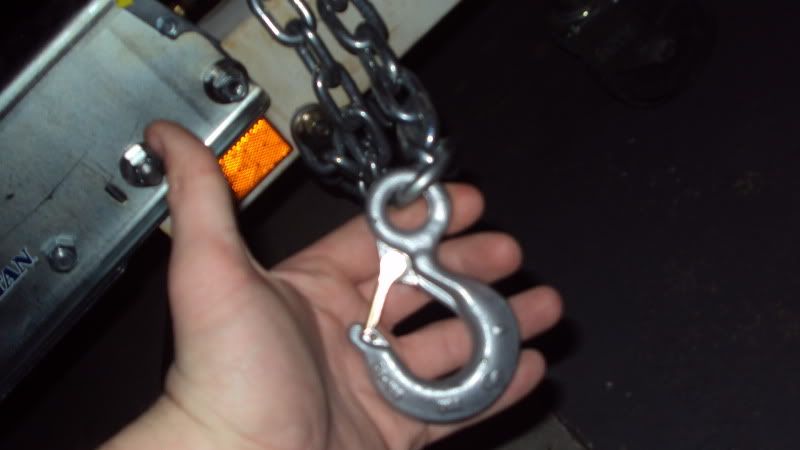

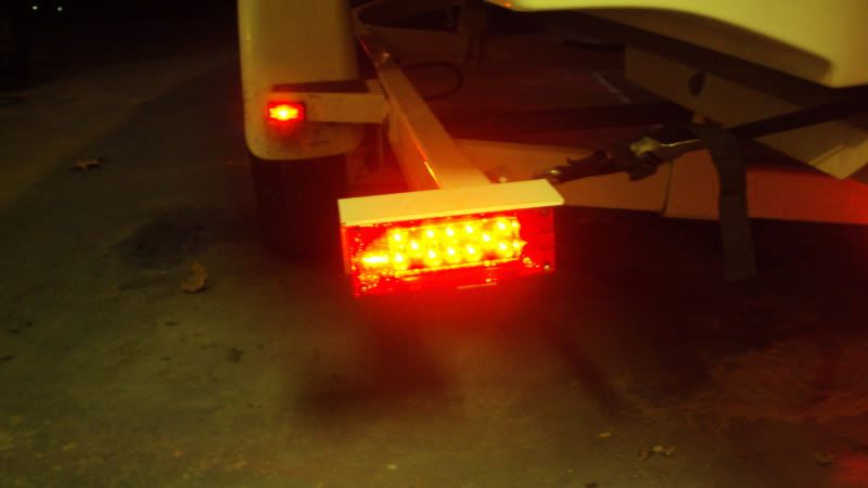

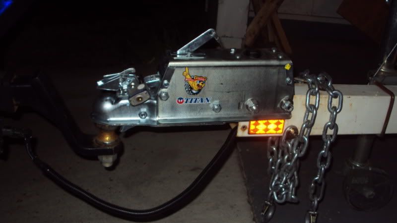

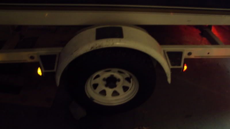

Now some pics of the trailer upgrades. I bought a new surge brake coupler and had to get new safety chains. The old ones were not long enough to reach my 6" lifted truck. Ended up making them 36" long on each side, but I will shorten them to 34" and then they will be just right. New pigtail, it was in pitiful shape. Amazing how people believe in wrapping bare wires with electrical tape on a boat trailer. New LED clearance lights and brake lights, only two left to convert are the front amber clearance lights. Gander Mountain has these lights for a fair price, but after purchasing them from Gander Mnt., I found them cheaper at O'Reillys. Oh well! Thats all for now!

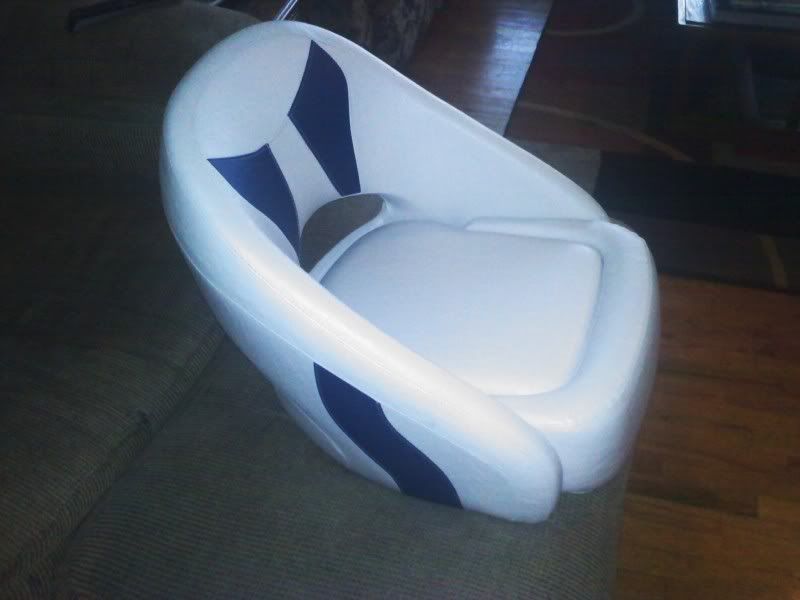

Almost forgot the pic of my new seats. Attwood Avenir, Off White and Navy blue with flip up bolster.

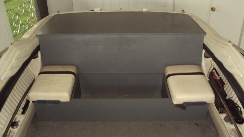

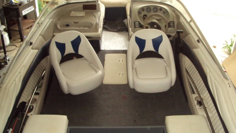

Finally Im down to the interior. Motor is in and running (sorta) and got some pics of what I got done so far. Got carpet laid and bucket seats installed and sun deck and rear bench made and painted. Its made of 3/4" Ply and its solid. Added a lot of wood bracing for strength. I got my foam ordered for the sun deck and rear bench. Next is sea trial if motor acts better after carb rebuild.

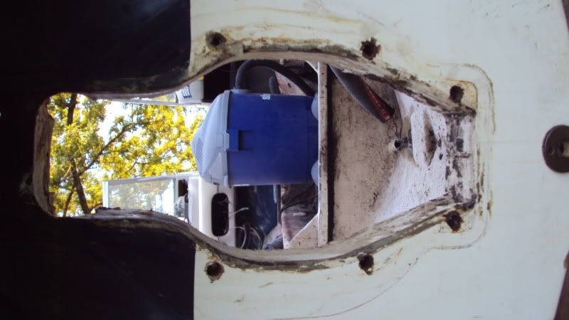

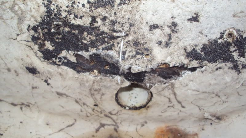

I know this looks rotted, but its actually oil stained. I have took core samples all over this transom and everything checks out.
How did you remove the side walls? I know there are bolts on the backside at the top, but where else is it bolted
