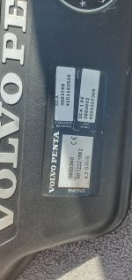

First, my boat: 2008 Regal 1900 w/ Volvo Penta 4.3 Gxi-G fuel injected i/o. i attached a pic of the model / serial # from the top of the engine in case it matters. The boat is on Keuka Lake, in western new york. Our primary residence is in PA, so I don't have the luxury on mesing with it in my spare time on evenings. I'm hoping to have a box of parts for our next trip up and dig into it full effort early Saturday morning.

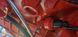

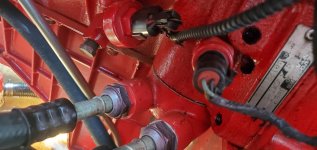

I got towed back to my lift and did some early diagnostics on Sunday before we left to come home. I confirmed all fluids were at appropriate levels, battery was in good shape and no connectors were obviously loose or not attached. Based on the warning tones, my first reaction is the oil pressure sensor is bad. I am having a really hard time finding the right part # for both the one wire low oil level sensor and the 3 wire oil pressure sensor. Can anyone help a) confirm that the two sensors shown in the pictures are in fact the pressure sensor and level sensor and b) help me reference the right part #s I need for replacement?

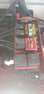

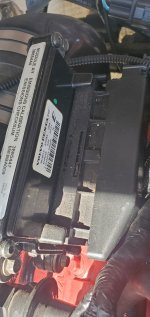

Finally some general questions: I have an OBD2 scanner for my cars. Do the newer marine engines use the same or similar protocol (google says no)? Is it worth getting a code reader for a boat (google says no here too)? I added a pic of the ECM and fuse box incase that was of any use to the thread.
