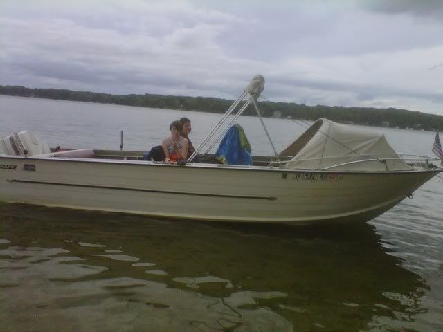

Re: '90 Alumacraft Project
Looking for input on floor covering and some concerns with them
I am looking at nautolex, just worried about trying to lay out a large sheet without any bubbles/wrinkles. I am aslo considering Durabak or Tuff Coat. Just wondering how they would adhere to storage compartment lids
