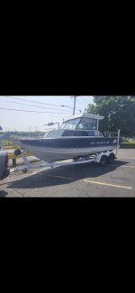

Hello everyone!
I just purchased my first boat. A 1989 Starcraft Islander 221v with the hardtop. It has an OMC 4.3 with a Cobra outdrive.
I'm super excited to get into the project. Sadly because I am still Active Duty Navy I won't be able to start until December of this year :(. In the meantime I'm conducting a ton of research on everything to do with restorations and boating in general and bug bombed it and tarped it. That's how I came across this fantastic forum.
The engine turns over great. Compression test showed 150 on all 6 cylinders. Smoothly in and out of gears. Oil and gear oil both looked great with no water. So engine runs great just a little anxious about it being an OMC.
Due to a leak from the front cabin windows, there was about 5 inches of water stagnant in the V all the way aft. This resulted in the cabin floors, board beneath the gas tank, and transom to be rotted. The flaking rotting wood also clogged the drainage.
Hull could use a coat of paint and probably a couple rivets need love.
I'm learning right now and have read almost every "spash" build about islanders and cheiftains.
My question to you all is, in the mean time what about restoring this boat should I conduct more research on? Or what should I start purchasing now to prepare for this large undertaking (other then a bottle of whiskey haha)?

Unfortunately a 1989 GM 4.3L V6 is probably not the best engine when you are considering outdrive conversion options.
It's not as bad as the mercruiser engine 170/470 abomination or the inline 6 cylinder, but its not the newer 1991 4.3L V6 balanced shaft non-vortec/vortec heads so replacing them isn't as easy to find.
At this point you really need to consider researching your options on what it would take to put mercruiser alpha 1 gen 1 or gen 2 on that boat from a complete used working assembly from a rotten boat with a good drive system.
OMC cobra drive system parts are becoming ever more and more difficult to obtain as OEM and aftermarket companies have been on a warpath after 2020 to discontinue parts that are not deemed critical to retain. OMC is out of business so don't expect aftermarket companies to remain if it's not profitable to sell their sterndrive parts.
Not as bad as if I said "Yamaha sterndrive" on scarcity, but something to keep in mind.
I think anything above $3250 for that boat is a bit expensive with a drive system made by a company who is no longer in business anymore and BRP/Evinrude does not make their parts.

Welcome (step) brother! Great boat with the full hardtop. Will be an insane fishing machine when rebuilt, and looks like it has been catching em for a while.
If your current motor/outdrive are in great shape, Id use em til they break, but thats just me. At the same time Id rebuild the boat in a way to make swapping to the merc combo easier to do. Unless you find a donor in the meantime and really want to go down that path to get the inevitable out of the way. Maybe you need some investors for the swap??
Lots of big tin being worked on right now. Would be pretty cool to see a bunch of them splashed next year. Will be tagging along on your build!
