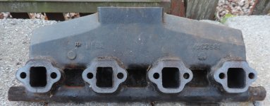

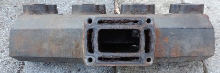

I pulled the risers and manifolds. As I suspected, I found water in part of the port manifold. The engine mounting surfaces look fine. The riser mating surfaces don't look too bad. I will try cleaning them up and getting new gaskets.
See attached pics, these are the port side, starboard is about the same.

They do look pretty good, you'll be able to tell better when the sealing surfaces are totally cleaned up.
49,536
Run a large bastard file across them and get thru the putting
Also clean out the crusty flakes. I use a section of 3/16 cable in a drill motor
