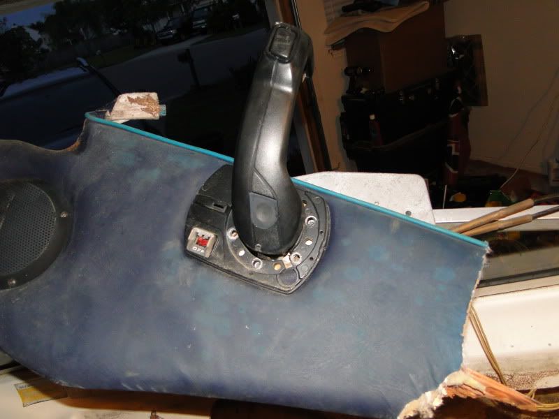

OK EZ, now you've got me. That dash looks sweet!!! I went from minimal possibilities to endless. Please reign me in.
Did you fair it out with epoxy and filler? Just paint?
Thanks! I just painted it. The stuff I bought had a course "wood grain" look on the one side but was smooth on the other so that side faces outward.
As mentioned it really doesn't have much strength but is great for anywhere that it's mainly just filling space. It's awesome to work with as far as drilling out for gauges and stuff like that.
