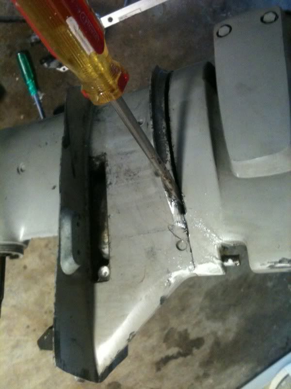

Hello and thanks for your time,
How long can a boat set in the sun uncovered before serious damage sets in?
I'm looking hard at a 2005 180 SSI. I'm told the boat was used 16 times from 2006-2009, then parked in the San Fernando Valley, Ca. where it has sat uncovered since (the last 2 years). Upholstery is cracked and sun burned (expected) and the carpet is starting to rot. My big concern is the gel coating, and flooring. There is no visable damage to the gel coating just faded and dirty. Can it simply be waxed or buffed? and the flooring seems solid but could it be rotted out in from under? I jumped on it and it didn't waver but I don't think thats the best way to check. The engine (Volvo 4cyl) with penta stern drive seems to be in great condition oil is clean and water free. Looking for any advice al all....
I'd be happy to hear any information anyone has regarding anything you think I should be checking or should look for. Thank you for your time,
Rick

oldjeep
May 17, 2010
6,455
Re: Purchase Advice for 2005 Chaparral 180 SSI
I'd expect every piece of rubber on it to be rotted out.

It won't just be the exposed stuff, exhaust bellows, fuel lines, engine drain lines, bilge pump hose, exhaust flappers if there are any. The weather just eats that stuff up.
I hope a good price is about 2K

Lou C
Nov 10, 2002
14,069
This boat was obviously left out in the elements and neglected. It looks awful for a 2005. I put a new interior in my old 88 Four Winns back in 2003-2006 and it looks new by comparison, because I used the cockpit and bow covers all the time, and it was covered with a custom canvas cover in winter. Interior work is expensive. And if the deck is wood under that carpet, with a thin layer of 'glass, there could be rot. I'd pass even with the low price...
