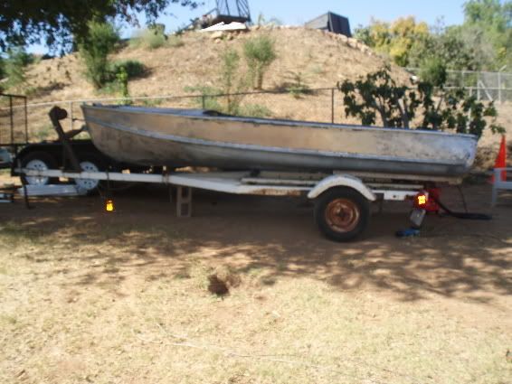

Hello,
First post on the forums. Have gained quite a bit of knowledge lurking on the forums but really havent had any q's until now.
Motor is 78 johnson seahorse tiller w/ electric start. Seems to be a fairly common and dependable motor. Owned the motor for 3 years or so and it has ran good until this past week.
Fishfinder has logged speed at around 20 MPH or so at WOT in the past.
Problem:
Motor not running at full power. Motor is now running at around 8 mph at WOT instead of 20+.
Symptoms:
Motor ran find last time out on boat.
Motor began to ran fine then once i hit WOT it bogged down to around 8 mph or so.
Turned throttle down, opened back up, went up to high speed then bogged back down to 8 or so.
Did this around two or three more times.
Now the boat will only go 8 mph at WOT.
Ive tried pumping the bulb and this doesnt help one bit.
Gas is fresh and new.
Spark plugs were replaced around 6 wks ago (could they be bad already?)
Motor is shooting out water at a steady stream.
Motor starts fine, idles fine, runs fine and seems to do okay at 8, just doesnt have full power!
Any ideas what this may be?
Looking forward to responses. Hopefully I can save myself some $$!
Thanks
