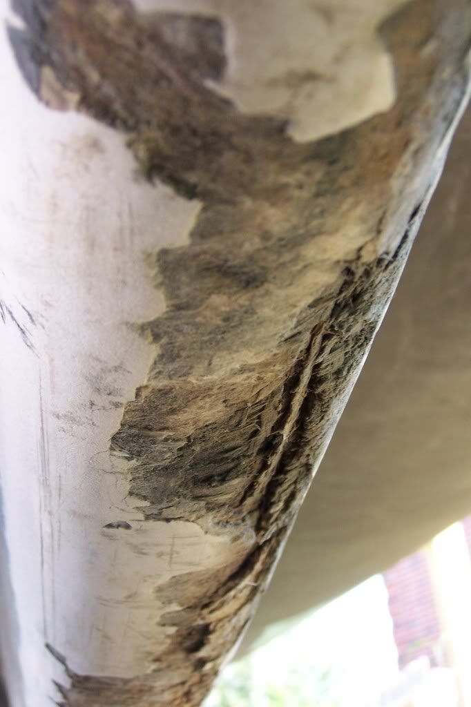

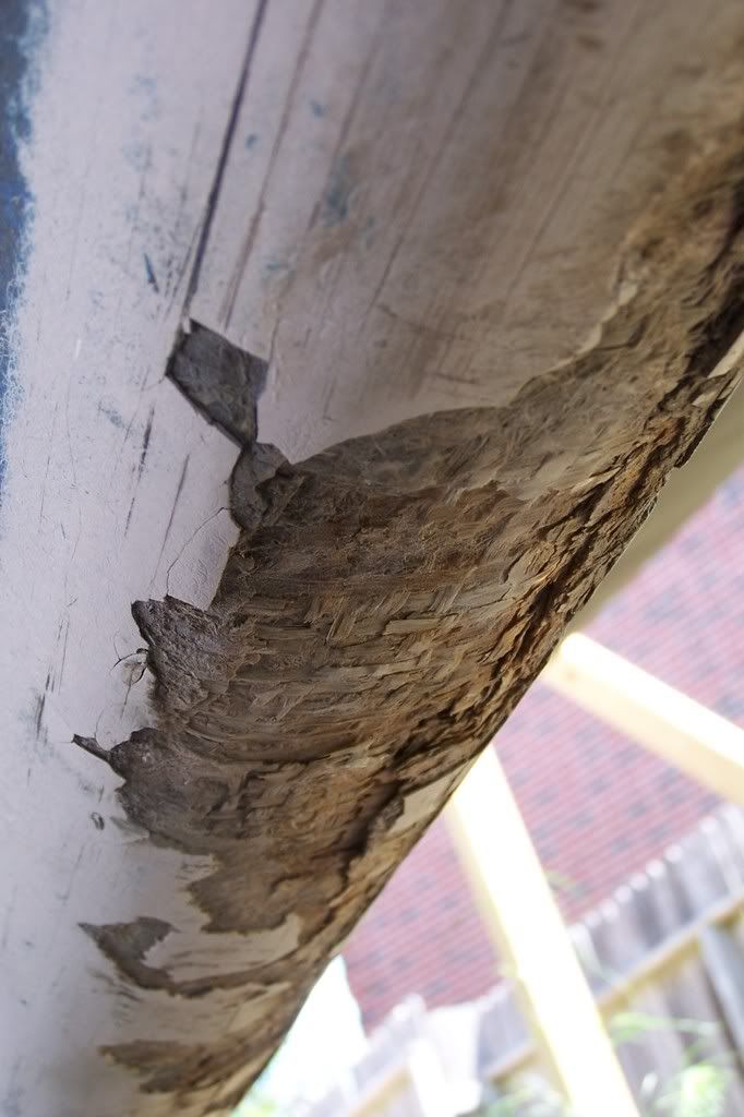

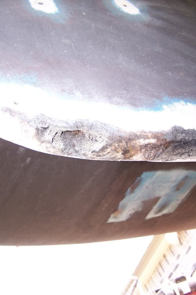

Have completely reworked and added new parts, impeller, gimble bearing, ujoints, new anode bolts, and new upper unit because of rust where anode bolts are located at 7 and 5 o'clock.
