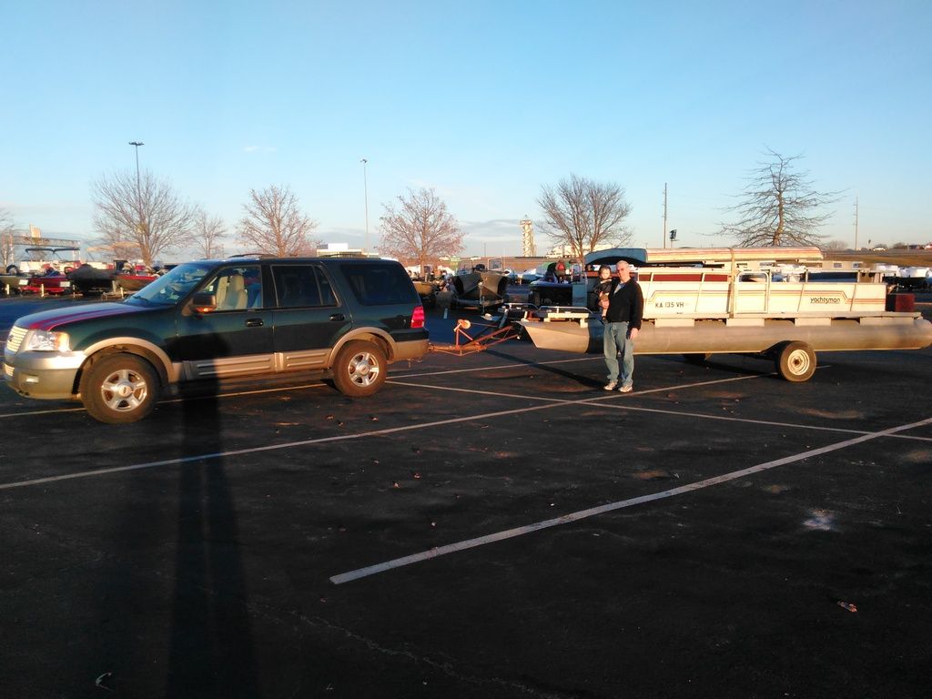

    So, after having a season of being a boat owner under my belt, the admiral and I decided that the ski boat project we had undertaken was a bit more than we wanted to deal with, and really too small of a boat for us to be comfortable. We decided it was time for the toon life. So, we put an ad on craigslist, hoping to trade our project (but pretty solid) ski boat for a toon. We found one right before the end of the year.
    I'm excited to not mess with stern drives and fiberglass!
    So here we go.
    RIP Manta Ray aka "The Natui Pickle" (our last name is pickle)
    And here's "The Nauti Pickle II"!! My father and son make excellent models. She's a 24' Playbuoy Yachtsman.
    We knew going in we would need a motor, and brand new interior. As long as the deck was solid (it is), we can work with the rest.

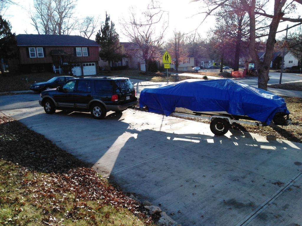

  • #2
    So I cannot have a bigger boat at my house unless we cut down a tree in the side yard! Tight squeeze!
